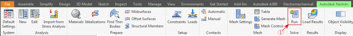

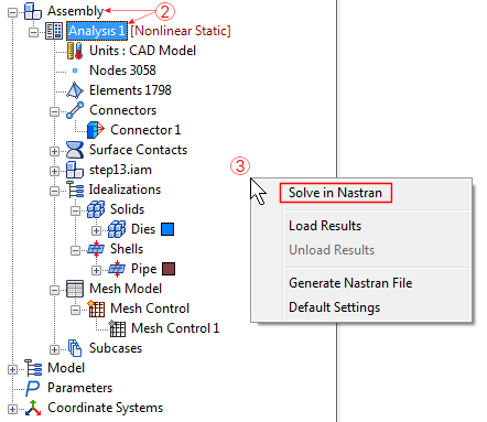

There are three ways to execute the Solve in Nastran command:
  1. Click the Run command in the Solve panel of the ribbon bar.
  2. Right-click the Part/Assembly or analysis name heading ("Analysis 1" in the example below) and choose Solve in Nastran from the context menu.
  3. Right-click on an empty space of the Autodesk Nastran Model Tree and select Solve in Nastran from the context menu.
