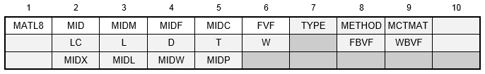

MATL8
Shell Element Orthotropic Material Property Generation
Description: Specifies the material properties for the generation of a shell element orthotropic material using MCT or Halpin-Tsai theory.
Format:
Example:
Field Definition Type Default
MID Material identification number. Referenced on a PSHELL or PCOMP entry only. Integer > 0 Required
MIDM Material identification number for the matrix material. See Remark 3. Integer > 0 Required if METHOD = 1
MIDF Material identification number for the reinforcement (fiber) material. See Remark 3. Integer > 0 Required if METHOD = 1
MIDC Material identification number for the composite material. See Remark 3. Integer > 0 Required if METHOD = 2
FVF Volume fraction of fiber. 0.3 ≤ Real ≤ 0.9 Required
TYPE Reinforcement type, selected by one of the following values:
1 = Aligned continuous fibers
2 = Spherical particles
3 = Oriented short fibers
4 = Oriented plates
5 = Oriented whiskers
6 = Plain weave fabrics (MCT only)
See Remarks 3, 4, and 5.
Integer 1
METHOD Calculation method, selected by one of the following values:
1 = Halpin-Tsai
2 = MCT
See Remarks 2, 3, 4, and 5.
Integer 1
MCTMAT MCT material input, selected by one of the following values:
1 = Perform MCT optimization on input materials
2 = Use input materials without modification
3 = Use default Carbon/Epoxy fiber/matrix
4 = Use default Glass/Epoxy fiber/matrix
5 = Use default Kevlar/Epoxy fiber/matrix
See Remarks 6, 7, and 9.
Integer 1
LC Short fiber critical length. Real > 0.0 Required if TYPE = 3
L Fiber length. Real > 0.0 Required if TYPE = 3, 4, or, 5
D Fiber diameter. Real > 0.0 Required if TYPE = 3 or 5
T Fiber plate thickness. Real > 0.0 Required if TYPE = 4
W Fiber plate width. Real > 0.0 Required if TYPE = 4
FBVF Fill bundle volume fraction. See Remark 8. 0.2 ≤ Real ≤ 0.37 Required if TYPE = 6
WBVF Warp bundle volume fraction. See Remark 8. 0.2 ≤ Real ≤ 0.37 FBVF
MIDX Material identification number for the MCT fill-matrix material. See Remark 3. Integer > 0 Required if TYPE = 6 and MCTMAT = 2
MIDL Material identification number for the MCT fill material. See Remark 3. Integer > 0 Required if TYPE = 6 and MCTMAT = 2
MIDW Material identification number for the MCT warp material. See Remark 3. Integer > 0 Required if TYPE = 6 and MCTMAT = 2
MIDP Material identification number for the MCT matrix-pocket material. See Remark 3. Integer > 0 Required if TYPE = 6 and MCTMAT = 2
