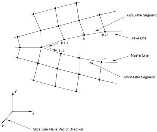

  9. Figure 1 shows a typical slide line contact definition. The slide line coordinate system z-axis defines the slide line contact plane. An alternate coordinate axis other than the z-axis may be specified using PARAM, SLINEPLANEZDIR (see Section 5, Parameters, for more information on SLINEPLANEZDIR). Relative motions outside the slide line plane are ignored and should be small compared to a typical master segment. The normal direction for a slide line segment is formed from the cross product of the slide line plane vector and the vector from master node 1 to master node 2. The definition of the coordinate system should be such that the normal direction points toward the slave region. For symmetric penetration the normals of the master and slave segments must face each other. This is generally accomplished by ordering the nodes on the master and slave lines either clockwise or counterclockwise depending on the direction of the slide line plane.

Figure 1. Slide Line Contact Definition
