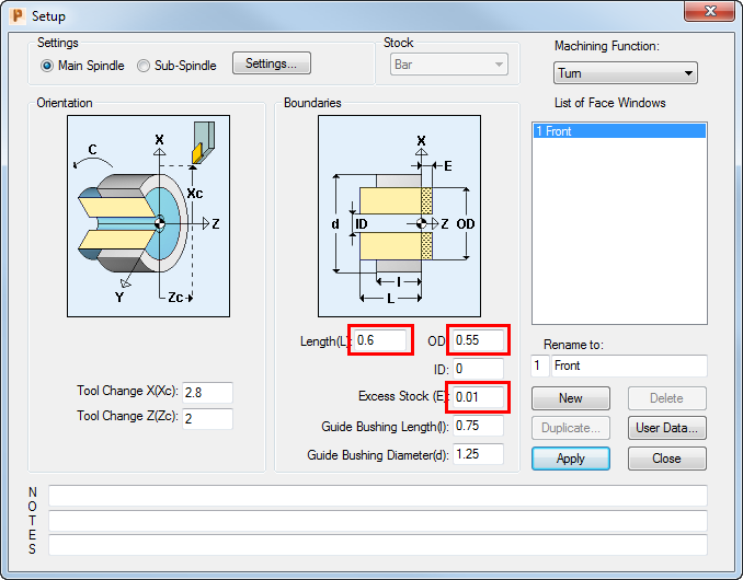

  2. Select View > Setup to display the Setup dialog and change the Length and OD values to those shown below:
  3. Click Close.
