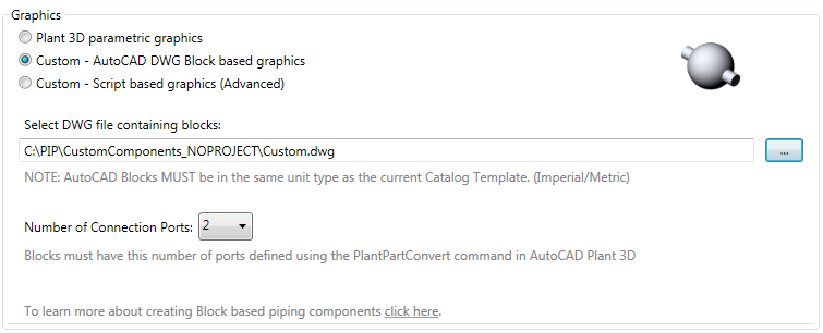

In a catalog template, you specify the component graphics. Parametric and block-based graphics are supported.
Catalog templates define component classes (for example: Elbow, Pipe, Tee, and Valve) and a size range.
You can specify parametric shapes, or block-based graphics. For more information on geometry types, see Modify Piping Components in a Catalog. You can also specify custom parametric (script-based) geometry.

If you use block-based geometry for your component, you select the DWG that contains the blocks for that part family. You specify the block names for each size in Excel.
