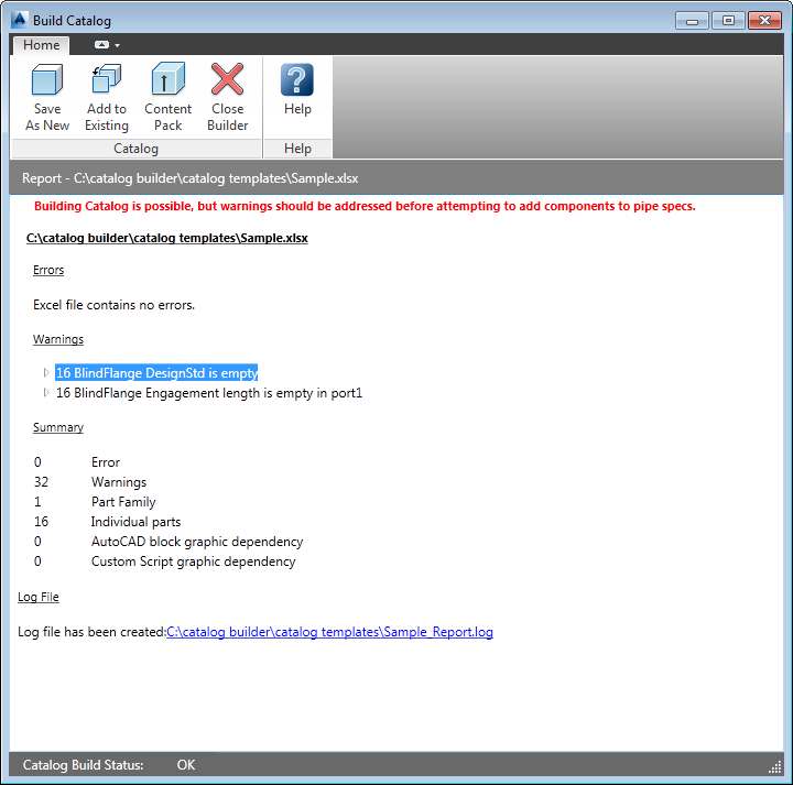

Build Catalog Dialog Box
Validates the catalog Excel file and creates a PCAT catalog file. You can also create a content pack or add components to an existing catalog.
If a catalog cannot be created, errors and warnings are listed and a log file is available.
Catalog Ribbon
Save as New
Creates a PCAT catalog file.
Add to Existing
Adds components to an existing PCAT catalog.
Content Pack
Creates a content pack. You can create and share content packs like the ones available on AutoCAD Plant 3D toolset Content Packs.
Report
Errors and Warnings
Displays errors and warnings after validating the Excel file.
