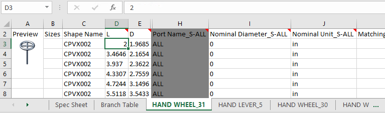

To edit exported spec data
  1. Open the exported Excel file.
  2. Go to the tab of the part you want to edit.
  3. Edit the content you want to change.
    Note: Some fields are write-protected so they should not be edited.
  4. Save the file.

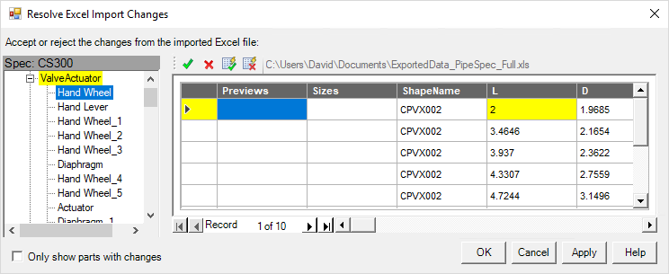

To import spec data from Excel
  1. In the Spec Editor toolbar, click Import from Excel.
    The Resolve Excel Import Changes dialog box is displayed.
  2. Select Only show parts with changes to view just the changes made to the data. All differences are highlighted with yellow.
  3. Use the following buttons to review the changes:
    • Accept each change individually.
    • Reject each change individually.
    • Accept all changes.
    • Reject all changes.
  4. Click Apply to save the modified spec data.
