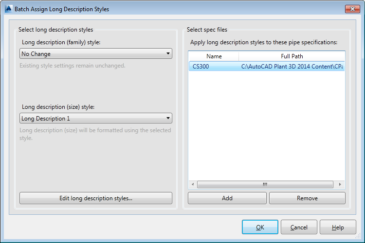

To batch assign long description styles
Note: Close any open specs before making batch assignments.
  1. In the Spec Editor, click Specs menu Batch Assign Long Description Styles.
  2. Under Select Long Description Styles, click the Long Description (Family) style drop-down list. Click a style.
  3. Under Select Long Description Styles, click the Long Description (Size) style drop-down list. Click a style.
  4. (Optional) Click Edit Long Description Styles to create or modify styles.
  5. Click Add. In the Windows Open dialog, navigate to the specs to be updated. Repeat this step as needed to compile a complete list.
  6. Click OK. Depending on the number of specs in the list, the process takes more or less time.
