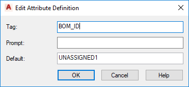

- In the Block Editor, double click on the attribute definition to display the Edit Attribute Definition dialog box.
- In the Tag box, enter BOM_ID.
Click OK to close the Edit Attribute Definition dialog box.
