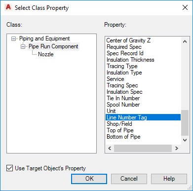

- Click Add Column. The Select Class Property dialog box displays.
- In the class list, click Pipe Run Component.
- In the Property list, click Line Number Tag.
- Click OK to close the Select Class Property dialog box.
- Under Table Layout, in the Show Column row, select Line Number Tag column.
