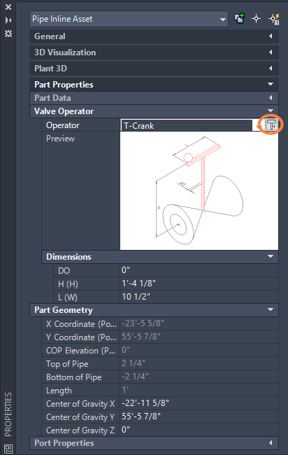

To override a valve operator
  1. In the drawing area, click to select a valve.
  2. Right-click in the drawing area. Click Properties.
  3. In the Properties palette, click Plant 3D Part Properties Valve Operator.
  4. In the Operator box, click the valve operator override button.
    Note: Select the preview image to view a larger version of the image.
  5. In the Override Valve Operator dialog box, under Select Operator Shape, click an operator shape (for example: T-Crank).
