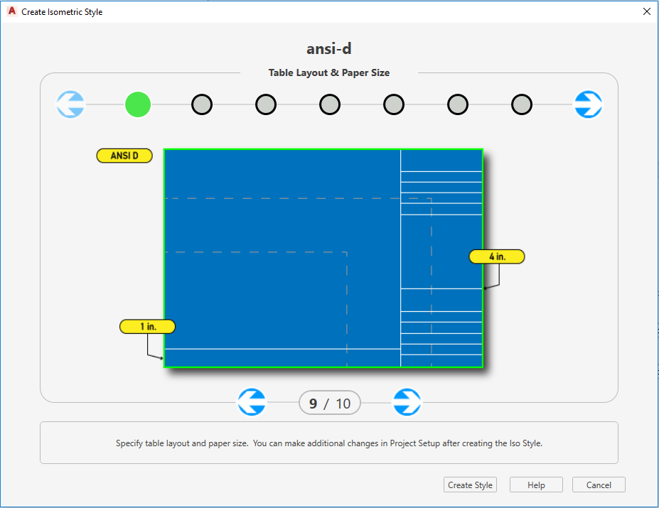

On the bottom, click the left and right arrows to select your Table Layout and Sheet Size. For example, ANSI D with a 4 in. BOM area on the left.

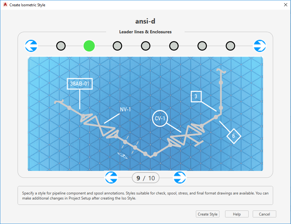

On the top, click the right arrow to display the next category.
Repeat steps 6 and 7 until all values for all categories are specified.
