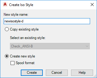

To create a new iso style
  1. On the ribbon, click Home tab Project panel Project Manager Project Setup.
  2. In the Project Setup dialog box, expand Isometric DWG Settings. Click Iso Style Setup.
  3. On the Iso Style Setup pane, click Create New Iso Style.
  4. In the Create Iso Style dialog box, under Name, enter a name for the new iso style.
  5. In the Base on Existing Style list, click an existing iso style on which to base the new style.
  6. Click Create.
