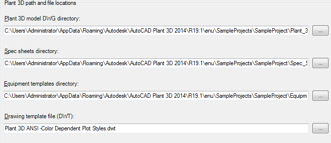

  1. On the ribbon, click Home tab Project panel Project Manager Project Setup.
  2. In the Setup tree view, expand Plant 3D DWG Settings. Click Paths.
  3. On the Paths pane, do one of the following:
    • Enter the file paths for the directories you want to change.
    • Click the [...] button to the right of each box to browse to the location where you want to store the directory and file.
  4. Click OK.

To set up pipe spec files
  2. In the Project Setup dialog box tree view, expand 3D Piping DWG Settings. Click Paths.
  3. On the Paths pane, under Spec Sheets Directory, enter the path to the location of your spec files or click the [...] button to browse to the location.
  4. Click OK to close the Project Setup dialog box.
