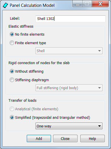

- In
Robot, in the Panel Calculation Model dialog, select the
No finite elements option for a slab:
- Select the slab.
- Click
Geometry
Properties
Panel Calculation Model.
- In the Panel Calculation Model dialog, double-click Deck slab (one-way).
Another Panel Calculation Model dialog opens.
- For Elastic stiffness, select
No finite elements. Click Add and Close.
Note: You cannot modify the default set of parameters. Change the default Deck slab (one-way) label to save changes.
- In the Panel Calculation Model dialog, verify if the Panel field displays the panels to which the calculation model should be assigned.
- Click Apply and accept changes in the model.
Note: After you modify the model, perform static calculations to obtain up-to-date results.
