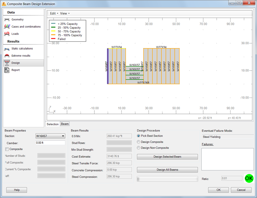

Check and design the behavior of composite steel beams according to the ANSI/AISC 360-10 code.
Use the Design tab to specify the following design settings:
- Section
To check the beam behavior, you can select different sections from the Section list. They are verified instantly:
indicates that a section does not fulfill the ANSI/AISC 360-10 design requirements. The Failures field displays information about the incorrect beam parameters. Select another section.
indicates that a section fulfills the ANSI/AISC 360-10 design requirements.
- Camber
Enter the camber value. If the Camber field is inactive, activate it:
- Select
Edit
Composite settings.
- In the Composite Settings dialog, select the Deflections and Camber tab.
- Select
Design beam with camber.
You can modify the camber value within the range of camber settings specified on this tab.
- Composite
Select it to design a beam as composite. It is possible only if positive moments occur in the beam. If negative moments occur, the composite option is inactive.
If you select the Design Composite procedure, the Composite option is selected automatically. If you select the Design Non-Composite procedure, this option is automatically deselected.
- Number of Studs
The Number of Studs field is active if you select the
Composite option. By default, it displays the minimum required number of studs for the selected beam. You can increase this value.
Additionally, there are two read-only stud settings:
- Full Composite. The number of studs required to achieve full composite action between the beam and the slab.
- Current % Composite. Shows the percentage of composite action achieved with the current stud number.
- Design procedures. Use them to select the optimal section.
- Pick Best Section. Depending on the beam behavior, it uses one of the remaining procedures: Design Composite or Design Non-Composite. See
Design Assumptions.
- Design Composite. It treats the section as a T-beam (steel beam composed with an RC slab). You can use this procedure for beams that can be designed as composite. See
Design Assumptions.
- Design Non-Composite. It treats the section as a steel beam section only. The RC slab is not included in the calculations.
- Design options. To start the design, click one of the following:
Design Selected Beam. It automatically selects the optimum section, number of studs, and camber for the beam selected in the graphic viewer.
Design All Beams. It automatically selects the optimum section, number of studs, and camber for all selected beams based on the internal forces resulting from the method of calculating forces you selected.
Design results include:
- Uniform studs distribution
- Segmented studs distribution
- Designed section
- Moment capacity
- Maximum moment
- Stud rows
- Stud strength
- Steel tensile force
- Cost estimate
- Compressive force in concrete
- Compressive force in steel
- Failures
- Ratio.
In addition, the graphic viewer presents studs designed on the beam.
After design is finished, click OK to update the
Robot model with changes in section, number of studs, and camber, and close the extension.
