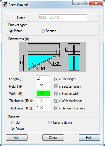

- In the Menu Bar, select .
- In the Brackets dialog box, click
(New Bracket).
- In the New Bracket dialog box, type the Name 0.2 x 1.0 x 1.0 and set the new bracket's parameters as follows and as shown below.
- Length: 0.2
- Height: 1.00
- Width: 1.00
- Thickness (Th 1): 1.00
- Thickness (Th 2): 1.00
- Position: Down.
Note: The bracket's position is set relative to the Z-axis.
- Click Add and then click Close.
- The new bracket displays in the list of brackets as shown below.

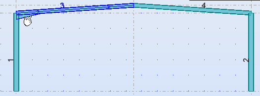

- Move the dialog box as needed and place the first bracket on the left side of the structure using either of the following methods:
- In the Brackets dialog box, select the Bars edit box and type the bar number where you want the bracket to be attached (in this case, 3 as shown below) and press <Enter> or click Apply. When you use this method the bracket is automatically assigned to the beginning node of the bar.
- In the graphical pane, click the left end of the top left bar. When you use this method you can select either end of the bar.
- Repeat this step to create a bracket on the right side of the structure.
