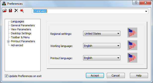

The Preferences dialog opens.
- Ensure that Languages is selected in the left pane of the dialog, and then select United States from the Regional settings list.
Note: The Regional settings set the default databases (for profiles, and materials), as well as the units and national codes to the standards of a country.
- Click Accept.
- Save the project as Frame_3D_Preferences.rtd.
- Close the program, and then start it again in order to update the settings.
The program restarts and the Regional settings are updated according to the American standards for profiles, materials, codes. In this case, the Imperial units will be used.
