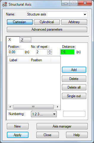

- In the Structural Axis dialog box, type a name for the custom axis, such as My Structural Axis.
- Three different types of axes can be used: Cartesian, Cylindrical, and Arbitrary. In this case, verify that Cartesian is selected as the type of axis.

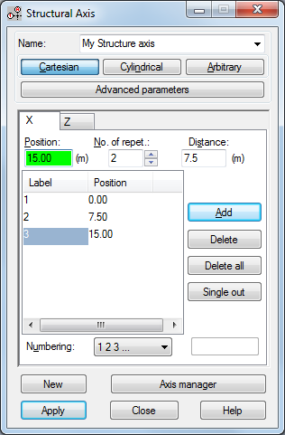

- On the X tab, set the Position to 0.00, No. of repet. to 2, and Distance to 7.5 as shown below.
Note: If the Distance is not displayed as meters (m), close the dialog box, save and close the project, and then open it again. The software should now be working in metric.
- When you press <Enter> after entering the Distance or click Add, the new positions are added to the list as shown below. Because these distances were an equal distance apart you could set a repeat and not have to enter each axis position.

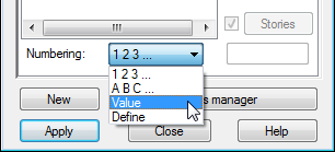

- Switch to the Z tab and set Numbering to Value as shown below.
- Set the Position to 0.00 and click Add.
- Add positions for 5 and 5.5 meters. Because these axes are at different distances from each other you need to enter them individually. Additionally, instead of numbers for the labels, the label equals the value of the position as shown below.

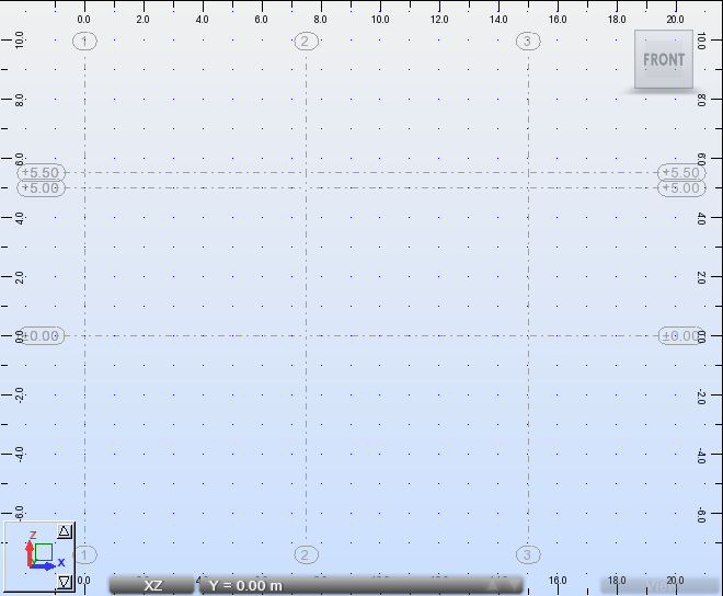

- Click Apply and then click Close.
- The structure axis displays on the grid as shown below.
