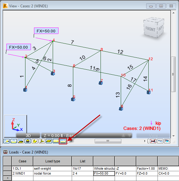

- In the Cases Selection box of the Selection toolbar, expand the Cases drop-down menu and select 2: WIND1.
- Click
(Loads
Load Definition...).
The Load Definition dialog opens.

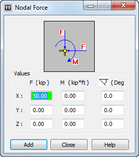

- In the Node tab, click
(Nodal force).
The Nodal Force dialog opens.
- Type value of load 50 in the FX box, and then click Add.
- Place the cursor in the Apply to field, and type "2 4" to select the nodes on which you want to apply a nodal force load.
Alternatively, go to the drawing area, and hold the Ctrl key to select nodes with numbers 2 and 4.
- Click Apply.
The WIND1 load appears in the drawing area and in the Loads - Case table.
- Click
(Load value descriptions) at the bottom of the drawing area to display the descriptions of loads values.

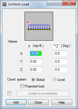

- In the Cases Selection box of the Selection toolbar, expand the Cases drop-down menu and select 3: WIND2.
- Go to the Bar tab, and click
(Uniform load).
The Uniform Load dialog opens.
- Type value of load -10 in the PX box, and then click Add.
- Place cursor in the Apply to field, and type "13 14" to select columns to which a uniform load will be applied.
Alternatively, go to the drawing area, and hold the Ctrl key to select columns with numbers 13 and 14.
- Click Apply.
The WIND2 load appears in the drawing area and in the Loads - Case table.

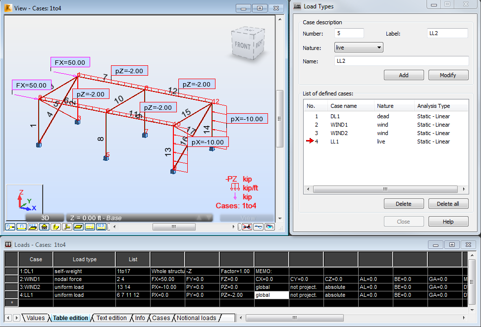

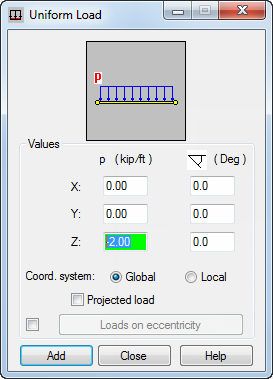

- In the Cases Selection box of the Selection toolbar, expand the Cases drop-down menu and select 4: LL1.
- In the Bar tab, click
(Uniform load).
- Clear PX box, and then type value of load -2 in the PZ box, and then click Add.
- Place cursor in the Apply to field, and type "6 7 11 12" to select columns to which a uniform load will be applied.
Alternatively, go to the drawing area, and hold the Ctrl key to select columns with numbers 6, 7, 11 and 12.
- Click Apply and close Load Definition dialog.
The LL1 load appears in the drawing area and in the Loads - Case table.
- In the Cases Selection box of the Selection toolbar, expand the Cases drop-down menu and select Simple Cases.
- All defined loads shown below:
