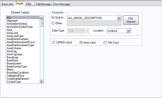

Options:
Option Usage
Element Type(s) Element type to check.
Built In Use built in parameters.
Other Use other parameters.
Pick Element Allows the user to select an element and parameter to test.
Data Type Data type of the parameter.
Location Parameter instance or type.
UPPER CASE Test parameter for upper case.
lower case Test parameter for lower case.
Title Case Test parameter for title case.
