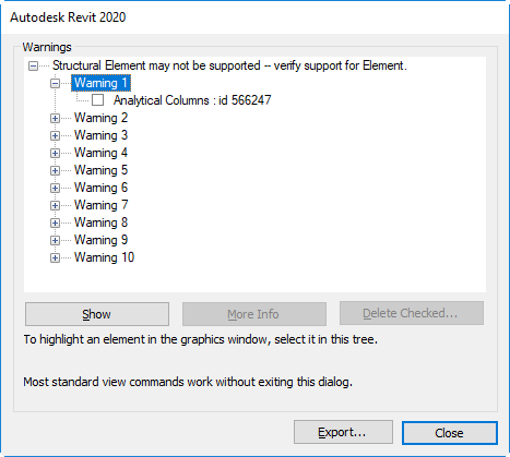

Unsupported element warning
View of unsupported element

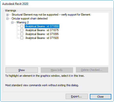

Circular support chain warning
View of circular support chain
