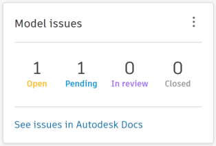

  • Model Issues: The Model Issues card displays the number of issues of each status for the model selected in the Model Selector. The link at the bottom of the card launches the user's browser and takes you to the issues list for the model in ACC or BIM 360. Note that the text of the link will change depending on the project type. You can select the issue statuses you are interested in by clicking on the menu and checking the status you want to see on the panel. This selection is stored separately for each user and each project.

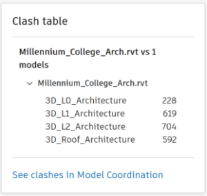

  • Clash Table Card: The Clash Table card shows the clash results for the currently selected model against the other models in the selected coordination space. Details of the results for each model can be viewed by clicking on the relevant arrow in the tree. The link at the bottom of the card launches your browser and directs you to the clash table for the model in the selected coordination space.

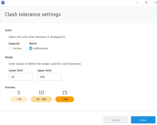

  • Clash Tolerance Card:The clash tolerance card reports the number of clash issues reported for the model within user-defined tolerance ranges. Click the link at the bottom of the clash tolerance card to open the clash table for the model in the selected coordination space.
    Determine settings for the tolerance card by clicking the ellipses menu. In the settings menu, you can switch between imperial and metric systems and define the ranges for clash tolerance. The lower limit and upper limits of the tolerance range define the lower and upper values to use for the central bucket.
    Any clashes with a tolerance lower than the lower limit will be placed in the first bucket and any clashes with a tolerance higher than the upper limit will be placed in the last bucket.
