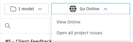

Enabling Online Access in the Issues Add-in
To enable online access, click the drop-down menu on the Issues Add-in panel, and click Go Online from the list.

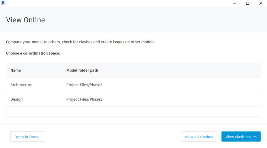

Once you have enabled online access, the View Online window allows you to easily access related online Model Coordination clash analysis results (for projects with Model Coordination enabled) or jump to the project folder for this model in Docs.
When Model Coordination is enabled in the project, you can view clash results by selecting the copy of the model for which you want to view clash results. Once a coordination space is selected, you can choose to view all clashes, view clash issues, or open in Autodesk Docs.
Note: If a project does not have Model Coordination enabled, a trial window for Model Coordination will be displayed. Follow the link on the page to start a free trial of Model Coordination.
Selecting Open All Project Issues will open your web browser and directs you to the Issues list in Autodesk Docs for the current project. For more information see Autodesk Docs.
