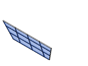

You can select multiple curtain elements on large curtain hosts using selection tools on the context menu.
Curtain hosts include curtain walls, sloped glazing, and curtain systems created by face.
When selecting multiple elements in a curtain wall, use the status bar and the Filter dialog to ensure that you have selected the intended elements.
You can select curtain panels in multiple ways.
To select all panels on a curtain host element, right-click the host element, and click Select Panels on Host. You can then select an individual panel, right-click, and click Select Panels to access the following options for selecting multiple panels:
