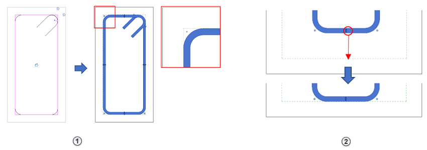

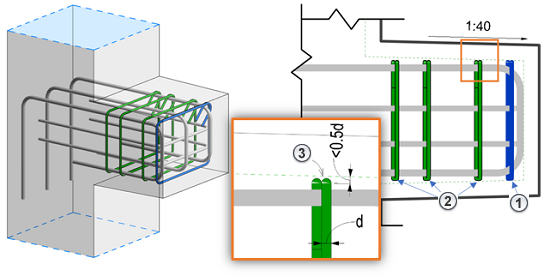

However, rebar flexes to arbitrary dimensions. Its position and geometry automatically set by considering the geometry of its host, as well as the presence of other rebar. Once the geometry is set, assigned constraints move and flex in response to changes in the model and with respect to the cover references of their host.
Rebar that touches a cover reference will snap and attach to that cover reference. Rebar cover parameters affect the attached rebar and bars that are attached to those bars. Changing the cover settings of the host will not offset other rebar that you have placed within the host.
