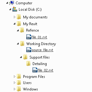

In the following image, a simple directory structure is used as an example.
In this instance, absolute and relative paths are defined as follows. Note the folder Working Directory. This has been named as such for illustrative purposes. A working directory can possess any name.
File Absolute Path Relative Path
sourcefile.rvt C:\My Revit\Working Directory\source-file.rvt source-file.rvt
file_01.rvt C:\My Revit\Reference\file_01.rvt ..\Reference\file_01.rvt
file_02.rvt C:\My Revit\Working Directory\Support Files\Detailing\file_02.rvt Support Files\Detailing\file_02.rvt

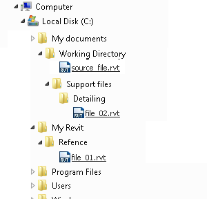

If the working directory is moved or renamed, paths can become unresolved (broken). In the following image, the working directory has been moved to the My Documents directory to illustrate this.
Now all of the original absolute paths are unresolved because they point to a specific location. The relative path to file_01.rvt is also broken as it resided outside of the working directory and didn't move with it.
