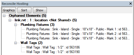

To review orphaned elements
- Click Manage tab
Manage Project panel drop-down
(Reconcile Hosting).
The Reconcile Hosting browser displays. By default, it is docked on the right side of the window. You can move it by dragging its title bar to the desired location. For more information on changing the size and position of the Reconcile Hosting browser, see
Dockable Windows.

Show an orphaned element
- In the Reconcile Hosting browser, select the orphaned element to locate.
- Click Show.
Revit displays the orphaned element, opening another view and zooming in, if needed.
