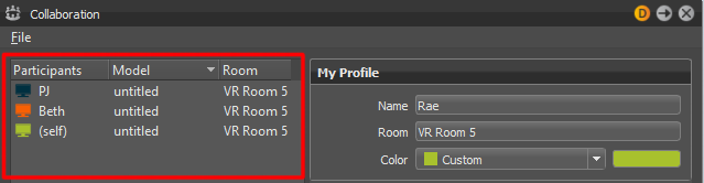

This pane lists all participants who have joined the session. It also indicates whether they have loaded the model. If a room location is supplied, it is also listed here, indicating the VR room(s) used in the session.
Participants - Participants who have joined a session are listed by name and color. To modify these settings, see the My Profile section of Collaboration Preferences.
Model - When a participant joins a session and has loaded a model, its information appears next to their name. If is displayed, the wrong model is loaded and you need to update your model.
IMPORTANT All participants must load the same file to ensure everyone sees the same thing during the session.
Room - Displays the name of the real-world VR room. To have the room name automatically filled in, see Collaboration Preferences.

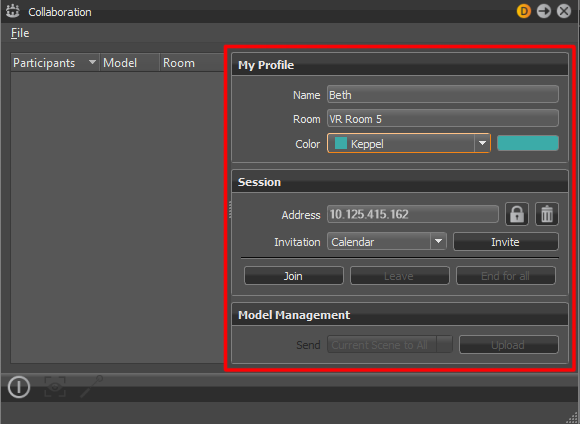

This pane contains three sections dealing with profile, session, and model management information.

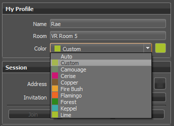

Enter information for setting up your profile.
Use the Collaboration preferences to set these ahead of time.
Name - Enter the name displayed in the Participant List and above your avatar. By default, your PC login is used.
Room - (Only for participants using HMDs) Enter the name of the VR room you are in. This let VRED know where you are in the same real-world space to avoid collisions.
For HMD users, all PCs in the same real-world space MUST set the same Room name. This tells VRED to enable safety mechanisms for these PCs to help avoid collisions. See this section for how to set up a room.
Color - Select a color from the drop-down menu. This will be used in the Participant List and for your desktop or VR 3D avatar.
Enter information for setting up a collaboration session.
Address - Enter an IP address or PC name for the server hosting the session. Use the Collaboration preferences to set this ahead of time.
This machine needs to be on the same network as the Cluster Service server to host. Ensure all participants can reach this server.
For invitees, if you have received a session address, paste it here to join a session.
Invitation - Select an invitation option from the drop-down menu to choose the type of session invitation sent to participants.
Invite - Click create an invitation for this collaboration session. For meeting and email invitation, a VRED session file is attached. See Setting Up a Collaboration Session for instructions of replacing the ORGANIZER-TO-ADD content.
Join - Click to join a collaboration session.
To join a session, you must have the same version of VRED as the session leader. The first participant to enter a session defines the VRED version for the session.
If your version of VRED doesn't match, you can leave the session, update your version, then return to the session or if all participants are in agreement, start a new session. See End for all for more information.
Leave - Click to leave the session. The session will continue until all participants have left the session.
As a participant, you might select this when running a version of VRED different from the session leaders. If you update your version, do NOT uninstall your current version.
End for all - Click when the session needs to be cancelled for everyone.
You might select this if most participants aren't using the same version of VRED as the session leader. The first participant to start the new session sets the version of VRED used.
Join a session, then use Model Management to push the session scene to participants. Use these tools to help send and upload scenes to all participants.
Since large files can take a while for participants to download and this action cannot be undone, we recommend you ask participants, in the invite, to leave enough time before the meeting to download the file.
Send - Click and select one of the following options:
Upload - Upload the session scene from the session leader. If a participant joins a session after this upload has been initiated, they are asked if they want to download the scene. If they agree, they receive the download.
