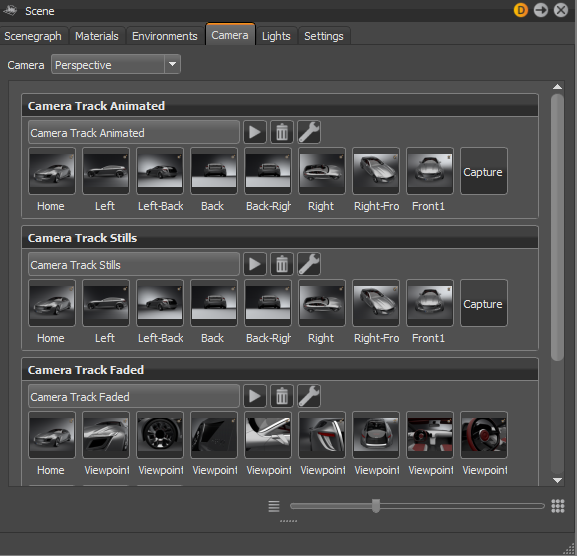

How to Change the Viewpoint
If viewpoints are set up for a scene, they are accessible through the Simple UI's Scene module.
Note:
When you change the viewpoint, it only affects you.
  1. In the main toolbar, click Simple UI, then select Scene > Camera to access the viewpoints in the Scene module's Camera tab.
    Viewpoints Desktop Simple UI
  2. Click a viewpoint to change your view.

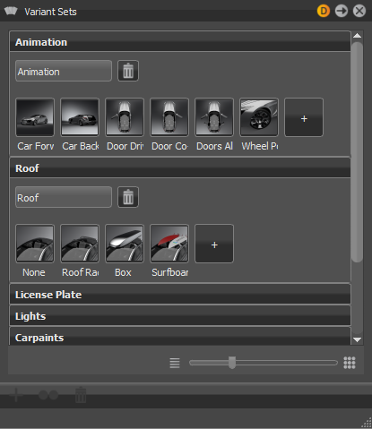

How to Access Variant Sets
If variant sets (VSets) are set up for a scene, they are accessible through the Simple UI's Variant Sets module.
  1. In the main toolbar, click Simple UI to access the Variant Sets (VSets) module.
    VSets Desktop Simple UI
  2. Click a variant set to change something in the scene.
