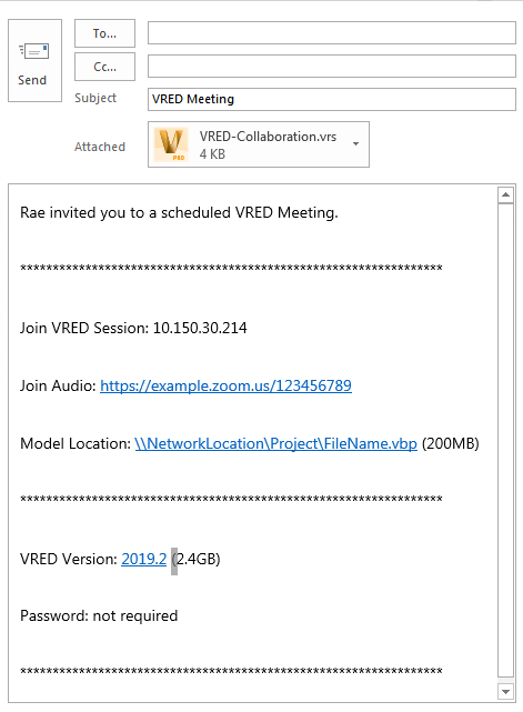

When someone has invited you to a collaboration session, you will receive notice. It could be an email, text, or meeting request. Email and meeting invites may include a VRED-Collaboration.vrs attachment.

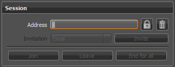

If the file is blocked and no longer attached, copy the Session Address and paste it into the Collaboration module's Address field.
Here is an example of a meeting request.
At the top of the invite is the name of the session leader. Below that, you will find the following:
Model Location - Provides a link to the VRED scene (.vpb file).
We recommend you load the model before the start of the collaboration session, as it can take a while, depending on the size of the file and other factors.
VRED Version - Displays the VRED version needed for this session.
