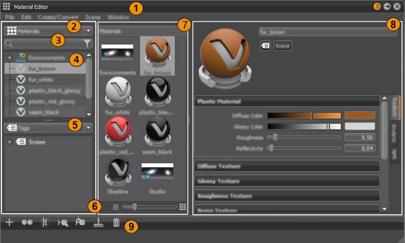

The Material Editor is comprised of the following:
Materials Section (Selector)
Tags Section (Selector)/Tree View

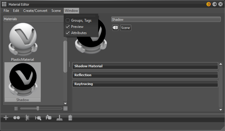

Contains the Groups/Tags, Preview, Attributes options for changing the appearance of the Material Editor. When an option is checked, that component is added to the editor. When unchecked, it is removed.
All Components
Groups/Tags Disabled
Shows the logical sorting and listing of the currently created materials. This is comprised of the Materials/Tags Selector, Search Bar and Filter, Material Tree, and Tag Tree.

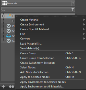

Right-click within the Materials section to access an assortment of options, including the following:

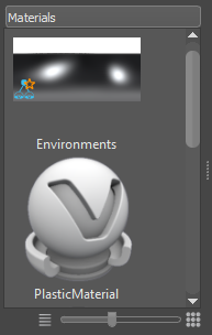

Shows a visual listing of the materials, depending on the selection. Click something in the Materials Tree. When a material group is selected, only the materials in that group is shown. If no material groups are selected, then the entire listing of scene materials is shown.
Contains quick shortcuts to commonly used Material Editor functions. Right-click in the Materials Section & Material Preview Pane to access the following options:
Creates a material. Choose from a large list of materials. See the Truelight Materials Reference section, for information on each material and its use.
Creates an environment map material. Choose from Sphere Environment, Skylight, Substance Panorama, and Environment Switch.
Accesses a sub-menu for opening or creating an OpenGL Chunk material. See About OpenGL Materials - Chunk Material for more information.
Accesses a sub-menu with options for copying, pasting, duplicating, and deleting, along with others for pasting attributes and texture size, dealing with inline images sequence, and locking and unlocking materials.
Provides a submenu for editing the usage of external file references. These files are imported into the Scene Graph and are present within its structure.
Makes it possible to change the selected object. The object's icon changes to Modified Assets (modified asset).
Saves the selected asset within the Asset Manager.
Updates the selected asset from the Asset Manager.
Removes the reference connection to the Asset Manager.
Accesses a sub-menu with options for converting the selected material into a TrueLight material, Phong Truelight material, Skylight, or Sphere Environment.
Loads a previously saved material from a file.
Saves the selected materials to a file.
Creates a switch with only the selected tree items.
Creates empty nodes.
Extends the selection in the Scene Graph to include nodes with the currently selected material.
(only available when environments is selected) Uses the selected material on the previously marked node in the Scene Graph.

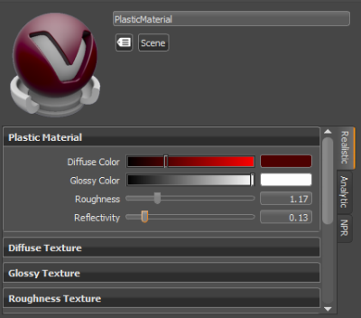

Shows all available settings for the currently selected material, along with a preview of the material. Any tags associated with the material are listed to the right of the preview.

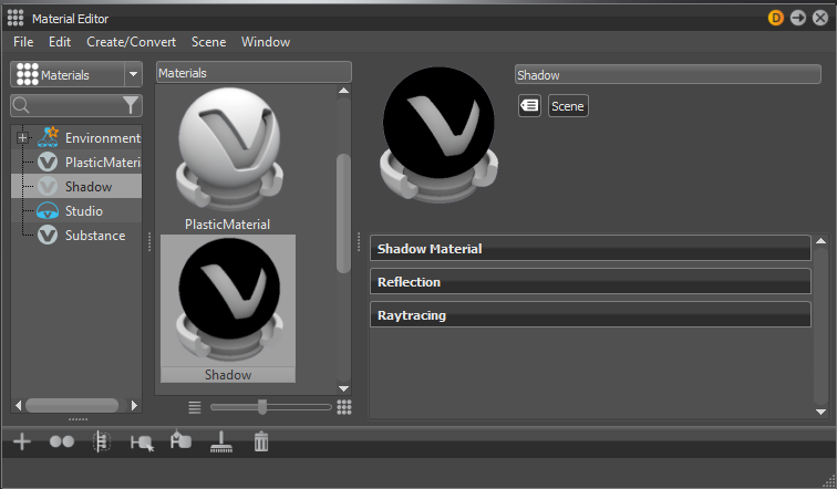

Descriptions for the shadow attributes can be found in Shadow.
