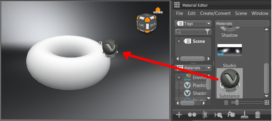

With your scene loaded, click-drag the Substance from the Material Editor onto the geometry in the Viewport.
Drag and drop a Substance onto geometry
To assign a different Substance, in the Material Editor, drag and drop a different Substance onto your geometry. The material will automatically update on the geometry.

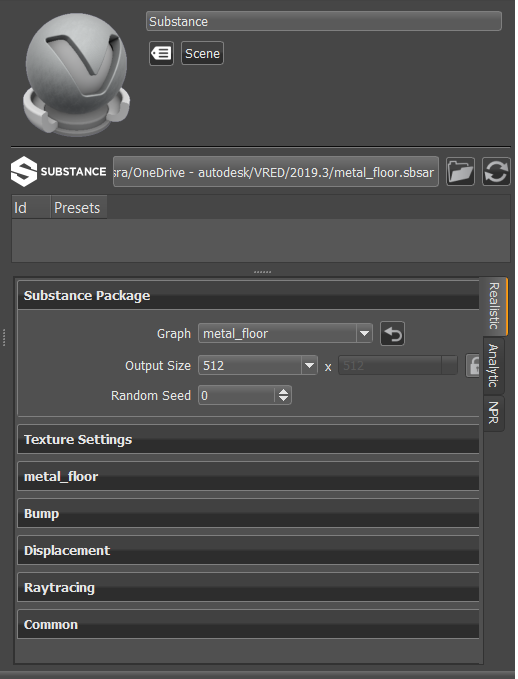

Tweaking a Substance
Substance parameter names are not changed upon import and appear as is in VRED. The Substance Material Designer set default values to all material properties. This is stored in Substance archive files. We read these values and attach all default values as fields in the created VRED material. We can use these defaults to reset the material to the original state. See the section, Resetting a Graph, that follows.

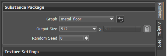

Changing Substance Resolution
Set the resolution of the current Substance material in the Material Editor. For example, one Substance material needs a lower resolution, but another Substance material needs a higher one. Using Change Substance resolution, you can do this.
Keep in mind, lowering the resolution reduces memory usage, but also image quality. Increasing the resolution improving image quality, but also increases memory usage.
  1. In the Material Editor, with a Substance selected, open the Substance Package section.
  2. Click the arrow next to Output Size to access values. Sets the resolution of the rendered Substance. The larger the value, the higher the image quality and more memory required. The Viewport updates to show the change.
