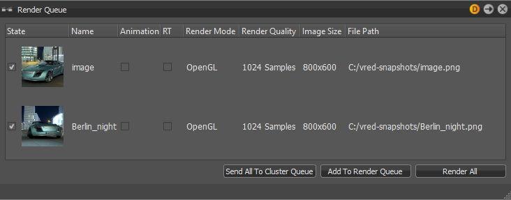

Every line within that queue represents a job that has to be calculated.
Visibility flags assigned to an object by a render layer are captured when something is added to the Render Queue.
Use this Python command activateRenderLayerState(string name) to activate every stored render layer state with the passed key-name.
State - Uses the checkbox to control job consideration on rendering. A preview image helps to identify the jobs within the queue.
Name - Shows the name chosen on file browse dialog box.
Animation - Indicates the type of job. Checkbox is selected on animations.
RT - Indicates the type of renderer. When enabled it uses Raytracing and Open GL when disabled.
Render Mode - Creates the output, based on the setting from the Scene module's Settings tab. It uses the selected image render mode that was configured there.
Render Quality/Image Size - Shows the settings set during job creation.
File Path - Shows image name and full path.

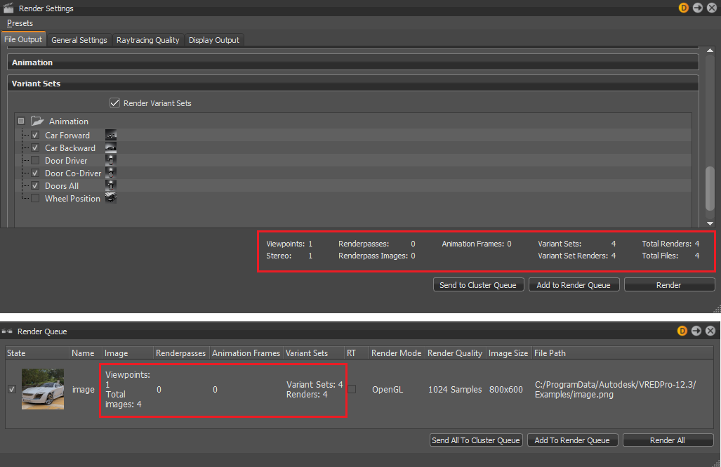

The Render Queue supports defined variants sets and captures the state of X-Rite and Substance materials. This means active X-Rite materials and Substance presets are captured.
