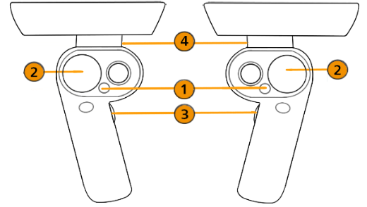

For the location of these tools, please refer to these images:
HTC Vive, StarVR, and VRHero/VRgineers XTAL
Vive Numbered
Oculus Rift
Oculus Numbered
WinMR
WinMR Numbered
Logitech VR Ink
Logitech VR Ink
1 VR Menu / Tools Menu
2 Teleport
3 Tooltips
4 Pointer
Tool menu VR Menu
Press this button to display the VR Menu or hide it. See VR Menu for more information.
Teleport Teleport
Use to teleport yourself to different places in a scene by touching the controller pad to cast a teleport arc, then pressing the pad to teleport. Teleport to different locations in the scene, into a car, or onto a car. See Teleporting for more information.
Tooltips Tooltips
Press this button to turn the displayed controller tooltips on or off.
Pointer Pointer
Press this to activate a beam and use it to point and indicate areas of interest.
