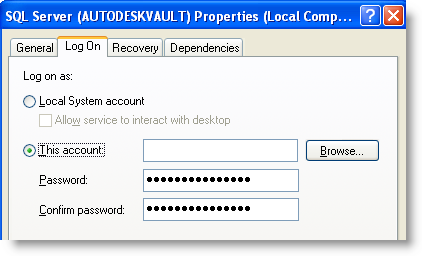

- In the Control Panel, Administrative Tools, double-click the Services icon.
- Double-click the SQL Server (Autodeskvault) service, and select the Log On tab.
- Select the This Account radio button, and enter a domain account in the form of Domain_Name\Domain_account (with the correct password).
Note: If you change the login credentials of the service, you are prompted to restart the MS SQL Server service. Please do so for changes to take effect. In addition, ensure that clients are not using the Autodesk Vault Server before restarting SQL Server.
