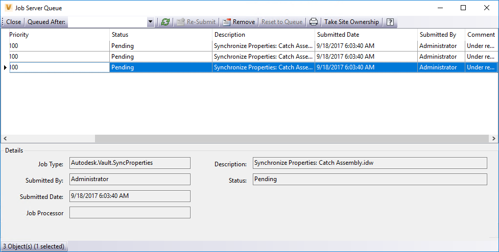

The Job Server Queue is a list, or queue, of jobs submitted by clients (Inventor, AutoCAD, Vault, and Autoloader) waiting to be processed. This queue is stored in and managed by the Vault Server.
The Job Server Queue dialog allows you to manage jobs that have been queued for publishing. On this dialog you can manually print jobs, resubmit a suspended job, review individual job details, and customize how job queue information is displayed.
This table describes the details of the Job Server Queue dialog.

This table describes the commands on the Job Server Queue dialog.
Command |
Description |
Close |
Closes the Job Server Queue dialog. |
Queued After |
Filters the list by showing the first 1,000 jobs queued after the specified date and time. |
Refresh |
Refreshes the queue. |
Re-Submit |
Reprocesses a job that has encountered an error. This button is only enabled when a job has been placed in error state. |
Remove |
Deletes a submitted job from the queue. |
Reset to Queue |
Removes the reservation of a job by the job processor. |
Prints the current queue grid to the default printer. |
Take Site Ownership |
Transfers ownership of the job’s reservation to the current user’s Job Processor. When a site that has reserved jobs is deleted, or a back up is performed but the information is restored to a different site, the pending jobs are deleted from the queue. This feature allows administrators to claim ownership for processing the job before it is deleted. |
Go To Folder Note: Right-click a specific job to see this option.
Locates and highlights the file in the vault. |
