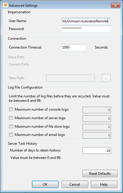

Set the new account in the Autodesk Vault Server Console
- On the Vault Server machine, open the Autodesk Vault Server console.
- Select Tools > Administration.
- On the Advanced Settings tab, select the Settings button next to Advanced Configuration settings.
- In the Advanced Settings dialog box, change the User Name to MyDomain\AutodeskRemote, and enter the corresponding password.
- Apply the changes and then click OK.
