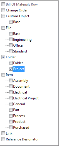

Associations define the entity classes that can use the user-defined property (UDP).
For example, if a UDP has an association of Change Order, then only change orders can use that UDP.
A UDP can also be associated with specific entity sub-classes. For example, a UDP can be created so that only Folders of type Project are able to use that UDP.
If a new UDP is not associated with any entity classes, it will not appear in the properties grid for that entity.

Folder |
Use the folder association to create a custom folder property. The custom property may be restricted to a folder sub-class, such as a basic folder or project. |
