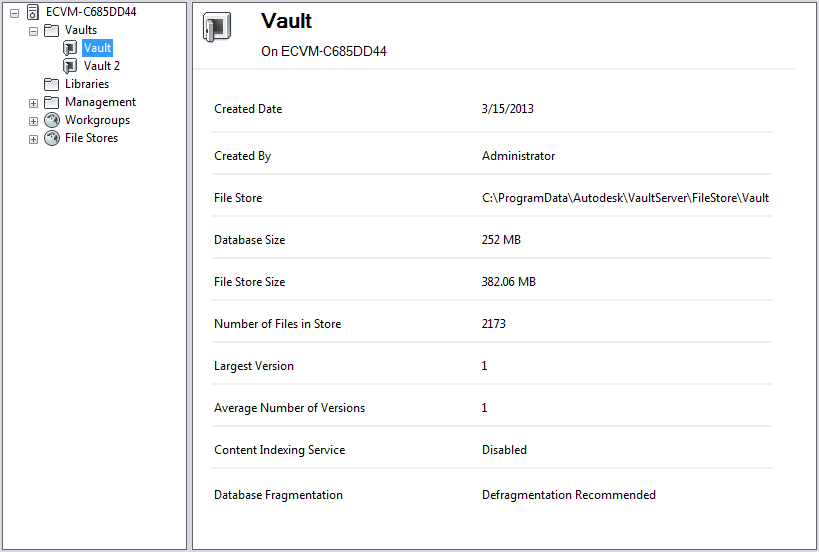

View the details for a specific vault.
	 - In the ADMS Console navigation pane, select a vault from the Vaults folder.
A summary of the selected vault is displayed. The statistics include the:
	 - date the vault was created
- name of the account that created the vault
- location of the file store
- number of files in the file store
- total amount of space used by the vault database
- amount of space used by the file store
- largest number of versions of any one file
- average number of versions across all the files in the vault
- whether or not database defragmentation is recommended
