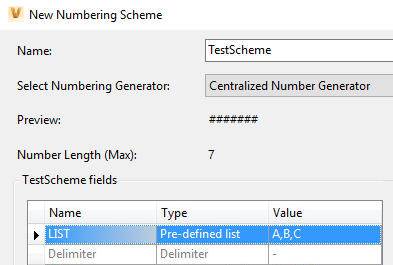

Consider you have the following numbering scheme called TestScheme.
Now you want to pre-pend the filename with a fixed text based on the selected document type:

Data Standard for Vault
The following sample implementation of GetNewFileName uses the numbering scheme TestScheme from above and the value entered in the Title as a parameter for the numbering scheme.
C:\ProgramData\Autodesk\<Vault Version>\Extensions\DataStandard\Vault\addinVault\Default.ps1
function GetNewFileName
    $numSchemes = $vault.DocumentService.GetNumberingSchemesByType([Autodesk.Connectivity.WebServices.NumSchmType]::Activated)
    $testNumScheme = $numSchemes | Where-Object { $_.Name.Equals("TestScheme") }
    $NumGenArgs = @()
    $NumGenArgs += $Prop["Title"].Value
    $genNum = $vault.DocumentService.GenerateFileNumber($testNumScheme.SchmID, $NumGenArgs)
    return $genNum + $Prop["_FileExt"].Value
