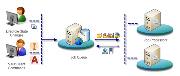

Before troubleshooting, see the Job Processor overview:
Job Processor has three main components.
Does Job Processor need to be installed on a server?
