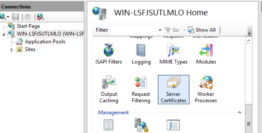

1. Create a Self-Signed Certificate

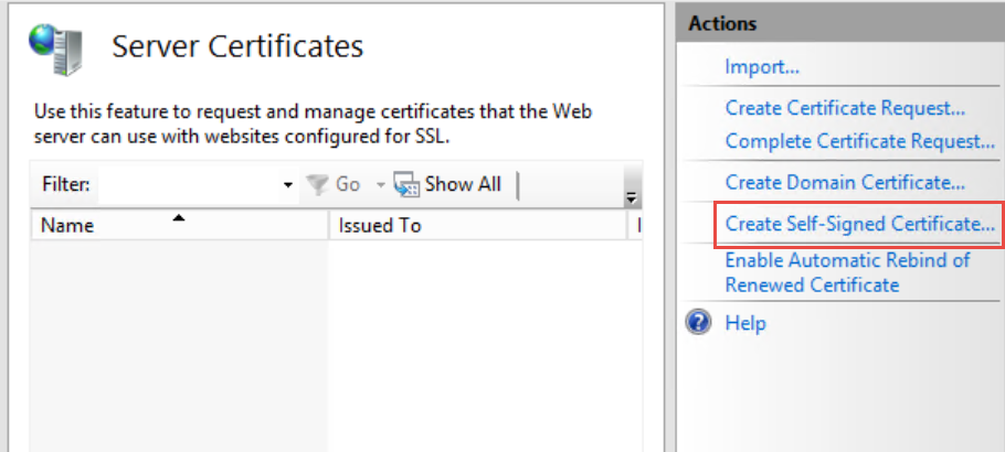

  1. Select the server node in the tree view and double-click the Server Certificates feature in the list view.
  2. Click Create Self-Signed Certificate... in the Actions pane.

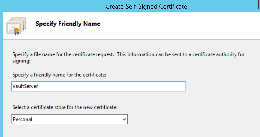

  3. Enter a friendly name and click OK.

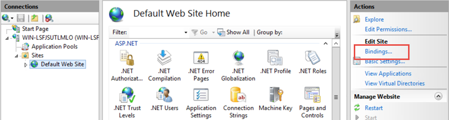

  2. Expand the Sites tree and select the website that is hosting the AutodeskDM Virtual Directory. In the image below, the website is Default Web Site. Select Default Web Site and click Bindings from the Actions pane.

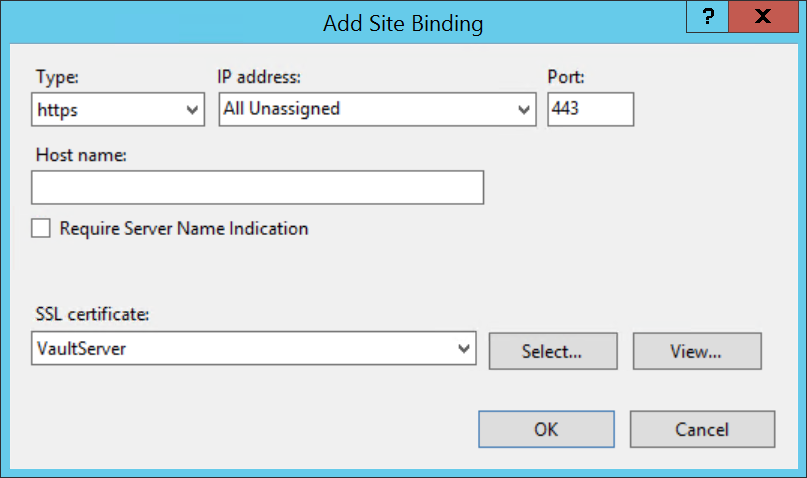

  3. Click Add and change the type to https and change the SSL Certificate to the certificate's friendly name that you installed. Click OK.
  4. Click Close.

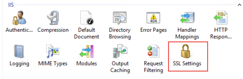

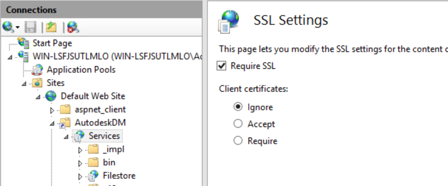

  8. Select the AutodeskDM Services Virtual Directory and double-click the SSL Settings button.
  9. In the SSL Settings page, click the Require SSL option.
    Note: Client certificates are not supported with Vault. Select the Accept or Ignore option under the Client certificates.
  10. Click Apply from the Actions pane.
  11. Repeat steps 8-10 for the AutodeskDM ServicesFile Store Virtual Directory.
