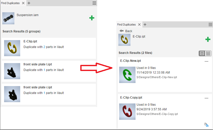

View search results for assemblies
  1. Click Search. Search results groups displays in the Find Duplicates panel.
  2. Click a desired group result to view individual duplicate parts.
    indicates parts with the same source (for example, parts created using Copy Design, or manual copies).
  3. Click Back to return to the list of groups results.
Controls the view display of the search results. The following view options are available:
Tiles View
Displays search results in a list with the image preview.

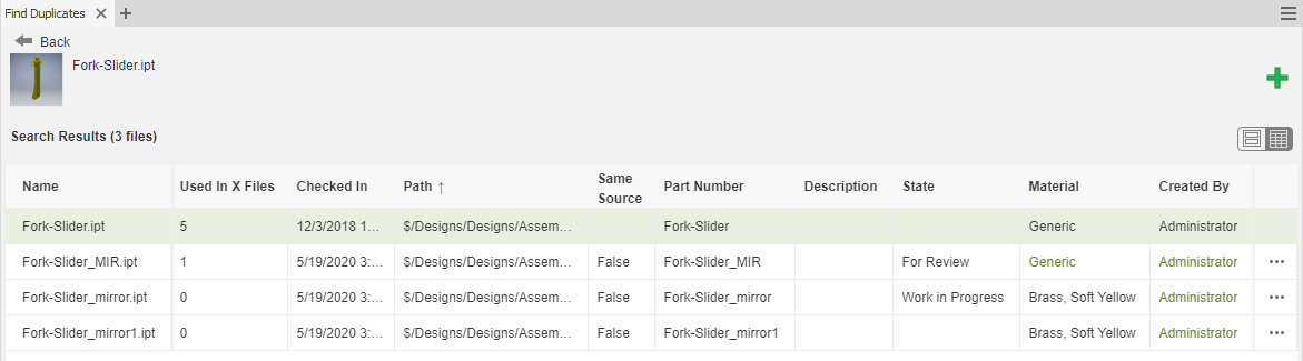

Details View
Displays the search results with details such as the material, a file path, or a number of files the source file is used in. The source file is listed first so you can easily compare the data about source file and found duplicates. Same properties are indicated by green color.
You can sort the columns by clicking the title. The panel can also be moved and docked to the bottom of the Inventor graphics window.
