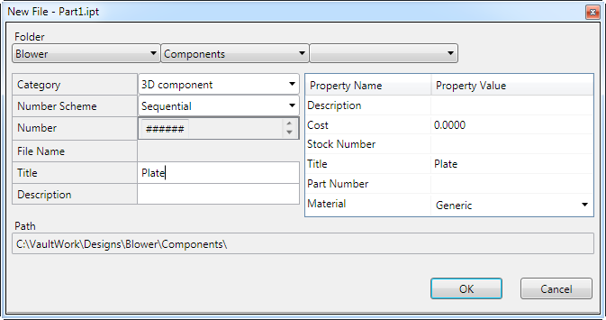

The Vault Data Standard dialog is available in Inventor and AutoCAD. Whenever you first save a file, the Data Standard dialog displays. Fill in the required fields and any additional fields set up by your administrator and click OK to save your data. The data is saved as a Data Sheet that can be modified in the future.

Users can enter a new title, description, and company information for the file. All other fields are automatically determined by the XAML.
    By default, the following fields are provided.
    Users can select a numbering scheme and, if applicable, any prefixes or suffixes. Users can also specify a folder for the file, and enter a title, description, and comments for the file.
    Note: If no numbering schemes are available for selection, the File Name field can be edited.
    The file name is generated when the user clicks OK.

When the Data Standard feature is enabled, you are prompted to enter file details every time you first save a file. This occurs whether you click Save on the main toolbar or on the Data Standard ribbon. Enter the required details and click OK to save your data. If the administrator has enabled the Check-in dialog for Vault, you may be prompted to fill your check-in details as well.

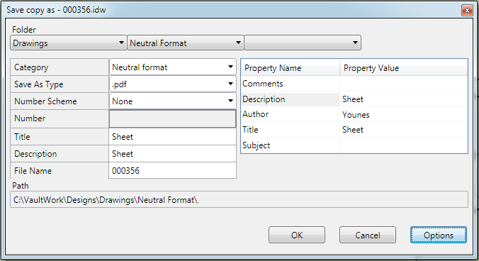

Use Save Copy As to copy parts, assemblies, drawings, or presentations in other formats, such as DWG, STP, PDF, or DXF.
  1. With the part, assembly, drawing, or presentation open, click Save Copy As.
  2. On the Save copy as dialog, select the category, the format to which you want to copy the open file, and a numbering scheme, if applicable. Enter comments, if desired.

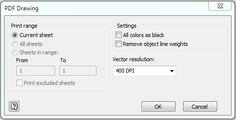

  3. Click the Options Button to customize the print range, display settings, or vector resolution for the file. Click OK.
  4. Click OK on the Save copy as dialog to save the file as the new format.
    The file is automatically saved in the workspace and the vault. There is no need to perform a Vault check-in.
