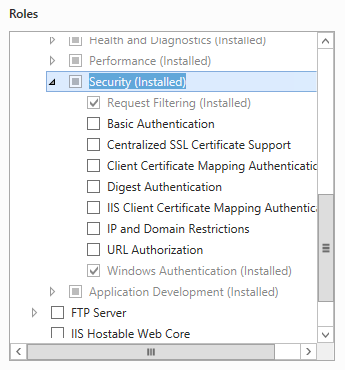

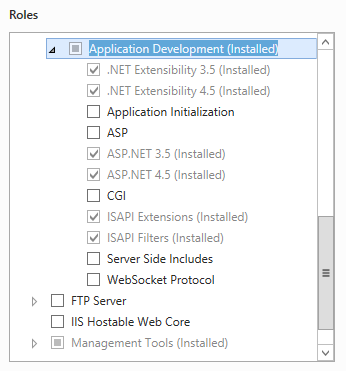

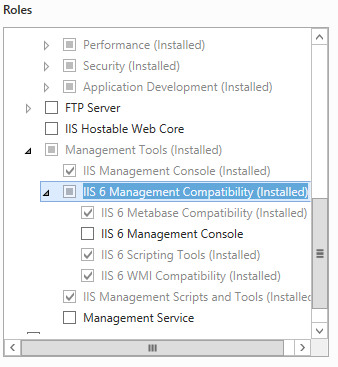

- On the Server Roles section, select the following Roles (SQL 2012 shown):
