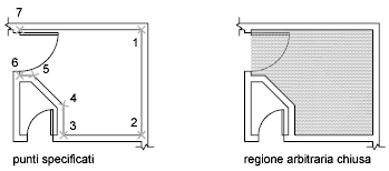

You can measure an area enclosed by the points you specify. The points must lie on a plane parallel to the XY plane of the current UCS.

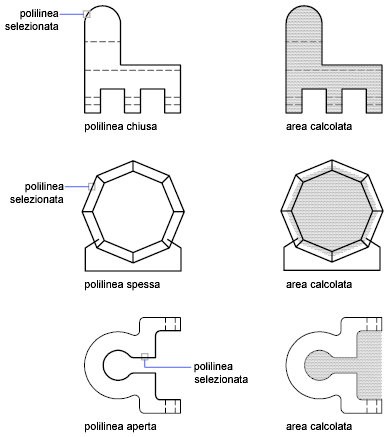

You can calculate the enclosed area and perimeter or circumference of circles, ellipses, polylines, polygons, regions, and 3D solids. The information displayed depends on the type of object selected:
You can calculate the total area of multiple areas by specifying points or by selecting objects. For example, you can measure the total area of selected rooms in a floor plan.
You can subtract areas from other areas. more than one area from a combined area as you calculate. For example, if you have calculated the area of a floor plan, you can subtract the area of a room.
