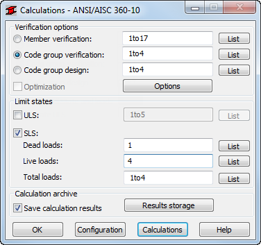

- In the Calculations dialog, select
Code group verification option, and then type "1to4" in the same line.
- In the
Limit states group of options select
SLS, in order to perform calculations for the service limit state, and then type the following loads:
- Dead loads: "1",
- Live loads: "4",
- Total loads: "1to4".
- In the Calculations dialog, click
Calculations.

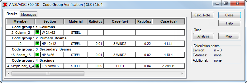

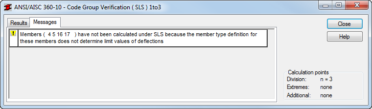

- The Code Group Verification dialog opens displaying the most significant information about the sections. The
Messages tab (as shown below), contains important information for the next steps in the design process:
Note: The Member Type for Bracings does not determine limit values for deflections. The next step explains how to set these parameters in order to perform the verification as required.

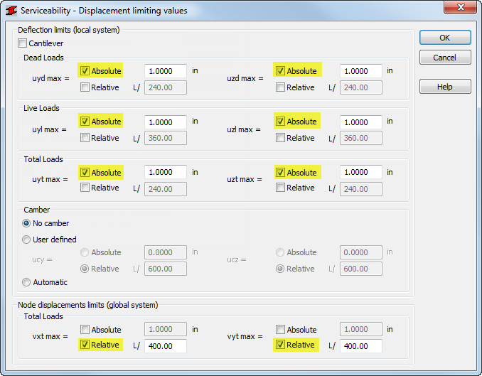

- Type
Simple bar_1 in the
Member type text box, and then click
Service.
The Serviceability - Displacement limiting values dialog opens.
- Select the following values:
- In the
Deflection limits (local system) group of options, select the
Absolute value for Dead, Live and Total Loads,
- In the
Node displacement limits (global system) group of options, select the
Relative value for Total Loads.
- Click
OK.
- Click
Save and close the
Member Definition Parameters dialog.

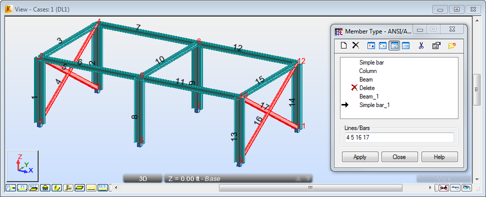

The new member type is now listed in the Member Type dialog box.
- Ensure that
Simple bar_1 is selected, type "4 5 16 17" in the Lines/Bars field as shown below.
Alternatively, place the cursor in the Lines/Bars field, then go to the drawing area, and hold the
Ctrl key to select bracings with numbers
4,
5,
16 and
17.
- Click
Apply, and then click
Close.

Results of the Code Group Verification are shown below.
Note: All sections are now properly defined for all the groups of members.

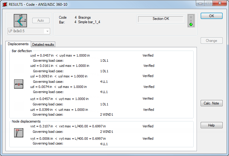

- To visualize the detailed results for a selected group, click
4 Simple bar_1_4 in the Bracings group.
The row is highlighted in black and the Results dialog is displayed:
- Review the results, and then click
OK.
