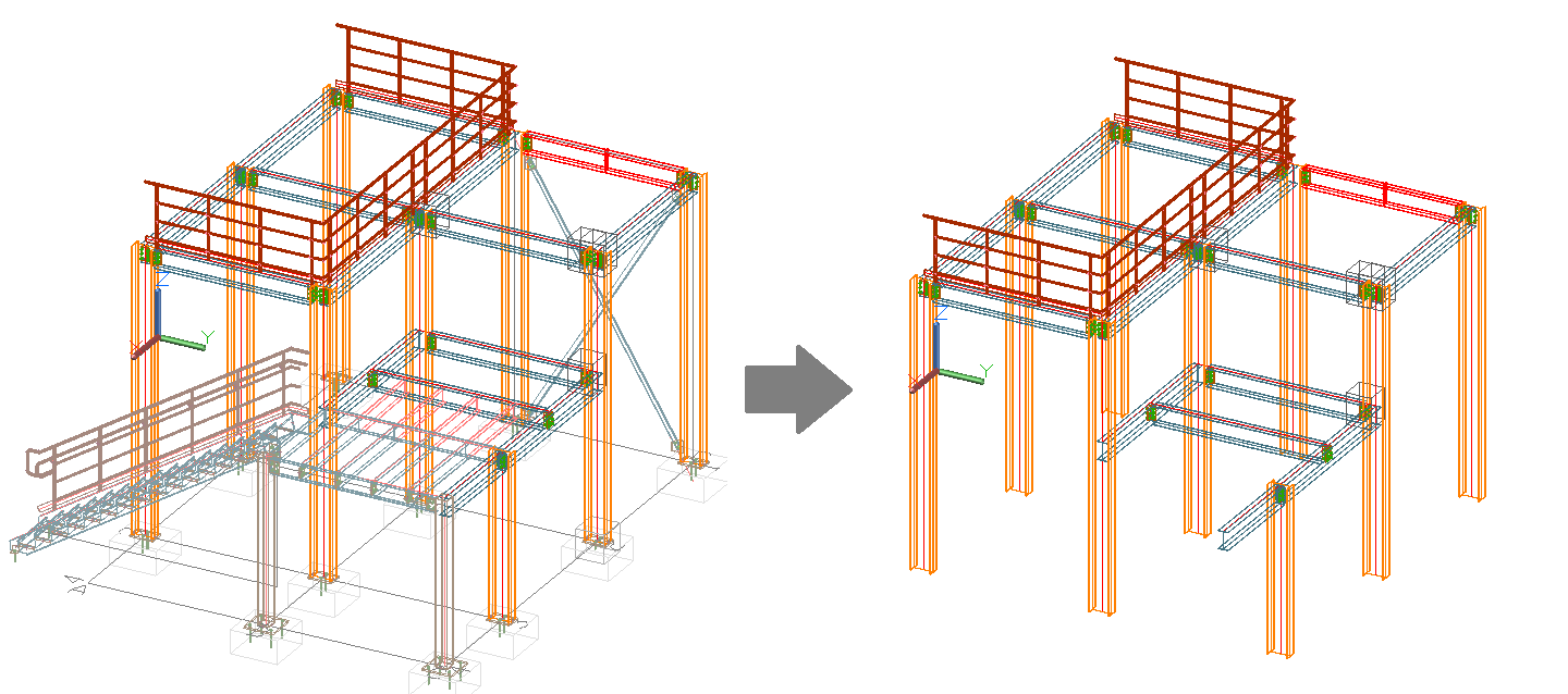

Users can only display their checked out elements, so that only part of the model is displayed. This helps to avoid adding elements to the wrong areas of the model and improves the display.
To display only the elements that have been checked out by a certain user:
In the Extended Modeling tab
Multi User panel, click
(Turn off other objects) to turn off the other objects. Press Enter.
Only the checked out items are displayed.
