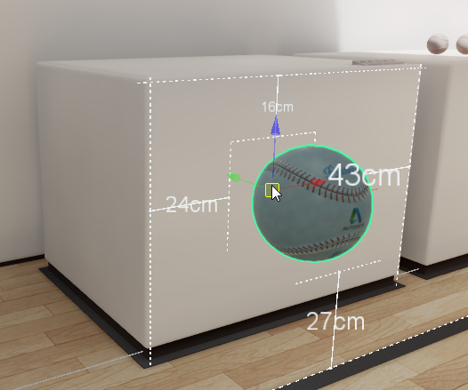

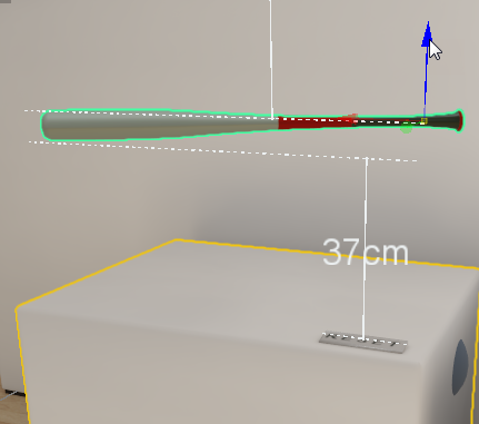

Measurements
When enabled, dragging any object shows measurements to nearby objects.

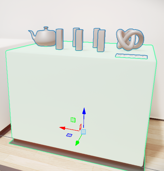

In the following example, several objects are placed on top of a white plinth. When auto-parenting is enabled, the objects placed on top of the plinth (children) are auto-parented to the plinth (parent). All auto-parented objects are outlined in blue and move with the parent.

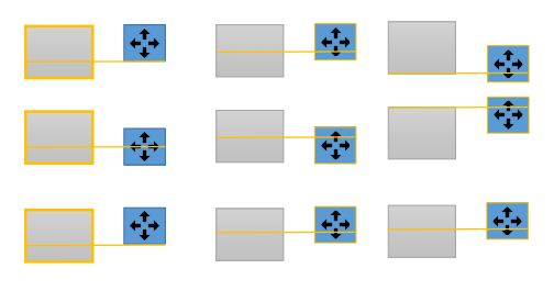

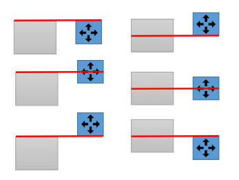

Snap to Smart Grid

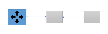

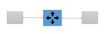

When enabled, the smart grid displays snap guides as you drag an object relative to neighboring surfaces. Red, yellow, green, or blue visual guides appear relative to the neighboring surface to show snapping options based on your object's location:

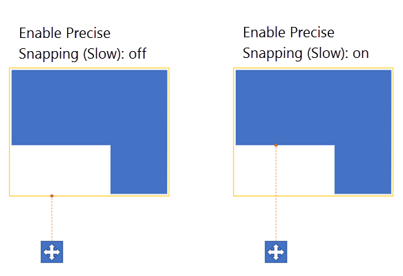

Enable Precise Snapping (Slow)
When enabled, snapping locations are computed based on the shape of the neighboring object. The follow example shows that more precise snapping is achieved, even with an irregularly shaped neighboring object.
